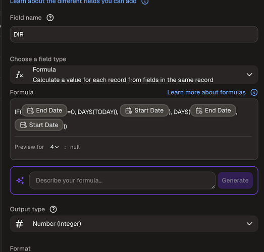

Thank you for the reply @jesse. I’ve just tried this out but it’s still not working.
As you can see in the attached image, it still previews as null.

Hi @darragh, I have tried using ISBLANK to check for blank/empty dates first, but it still returns null.
I also created a column to update “Today’s date” using Make automations and try to use that to subtract the days from “Start Date” if the “End Date” is empty, but i’m still getting null.
Seems like the problem is from the blank date field.
Have also reached out to Noloco support/engineering team and they’ve been on it for 2 days with no significant result yet.
