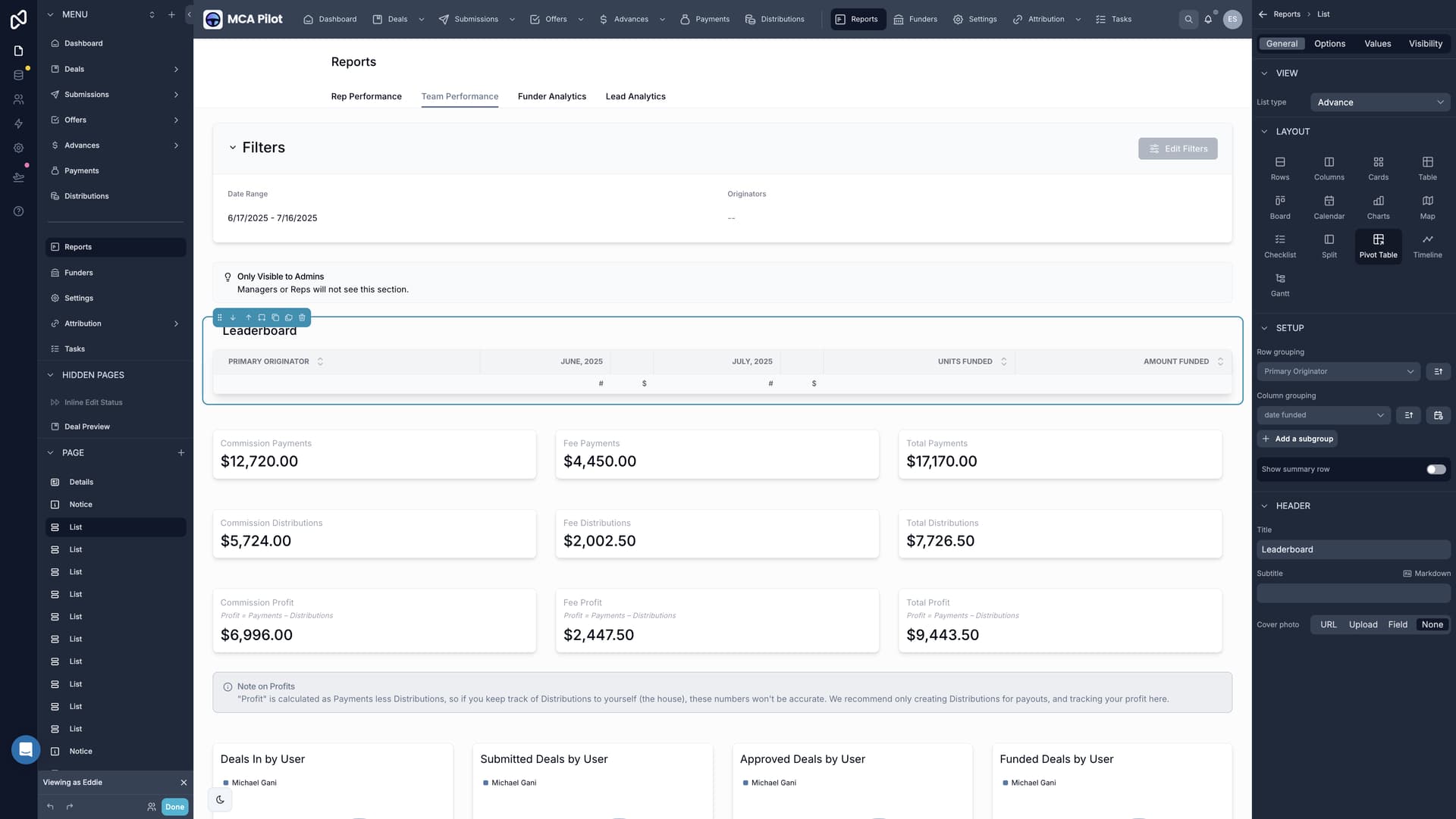

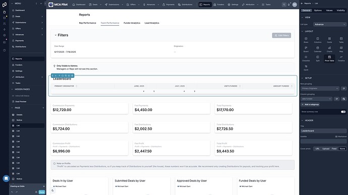

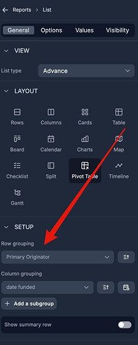

I’m trying to figure out how to display Advance records grouped by Primary Originator, where the aggregate metric is sum of the “amount” field and count of the “ID” field.
I think my issue is that I only need the row grouping and not the column grouping, but it forces you to choose both.
A workaround is to group the “date funded” field by month, but for some reason no data shows up.
There are some filters applied, but I noticed this issue before any filters were applied, so I believe they are unrelated.
Do you know if I’m doing something wrong or if there’s a different way to accomplish what I’m looking for?

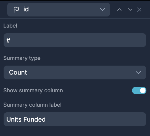

What do you have in the values field, is the ‘Amount’ field and aggregated by sum? Can you screenshot it?
Amount Field:
ID Field:

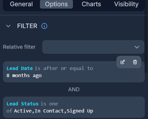

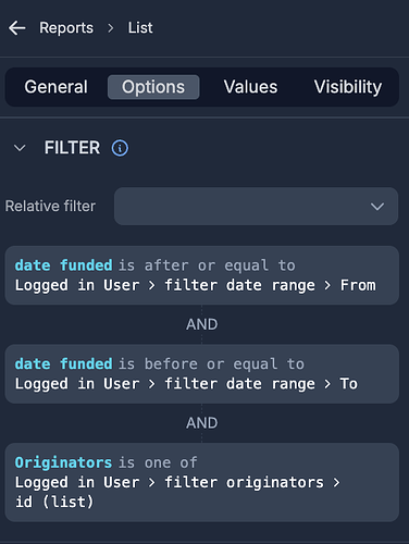

Filters:

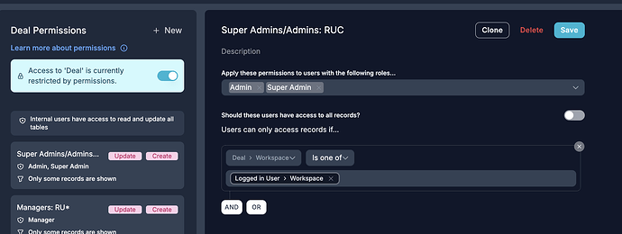

If so, does removing the “Logged In User” from you editor filter so its sort of like the below work?
Hard to tell how its setup but currently that’s set to only show records from, I’m guessing you (logged in). If the permissions are being applied at table level do you need to apply them again in the filter?

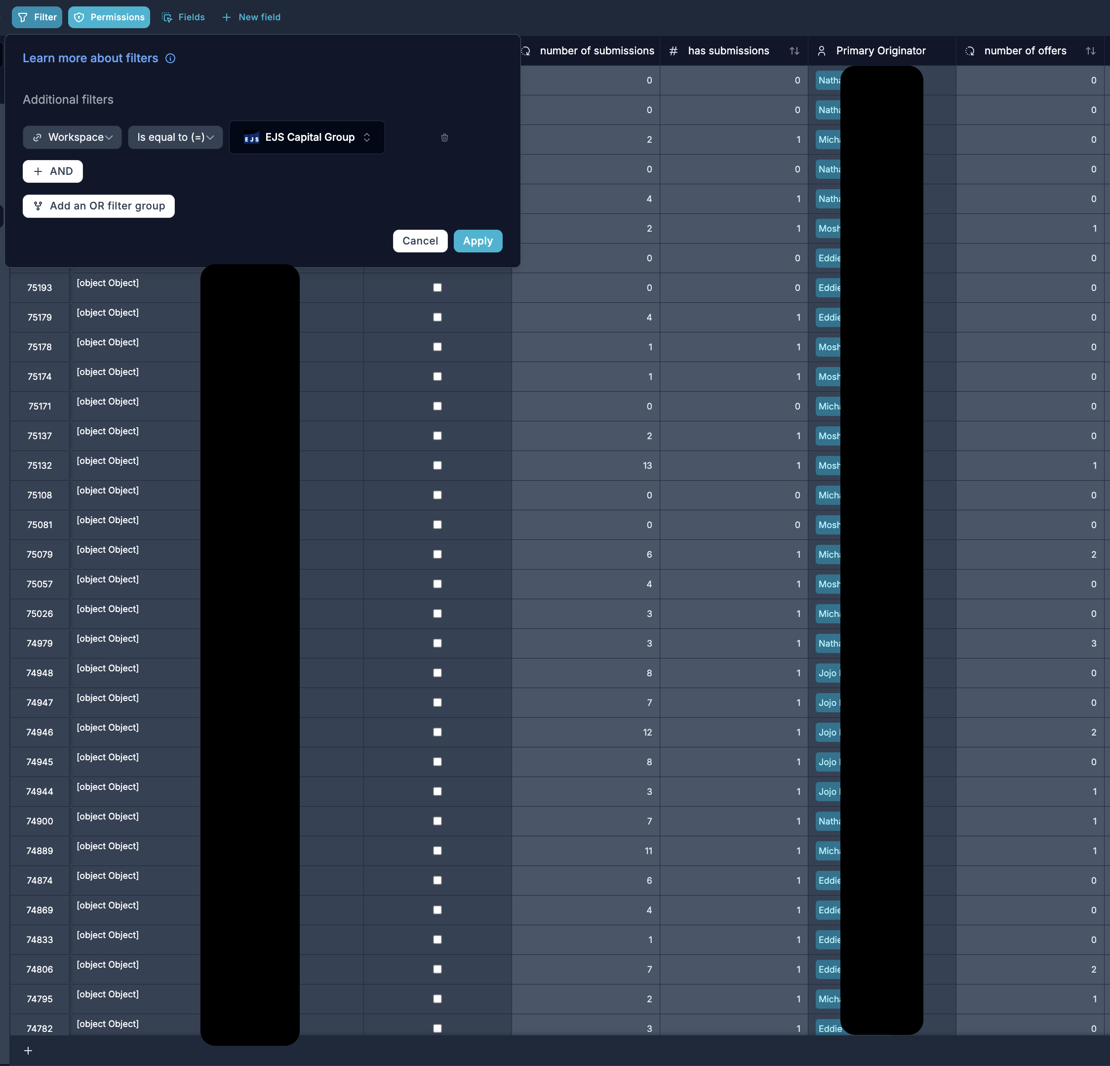

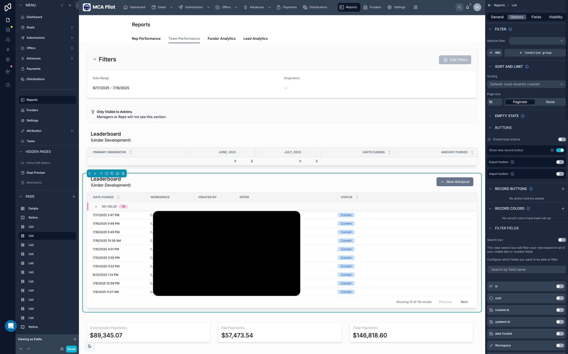

Thanks for the suggestions. I can’t remove the backend permissions because this is a production environment. I did remove all the frontend filters, though, and the Table displays more than 0 records. But it shows that all records have “No Value” for the Primary Originator field:
However, in the backend Data tab I see clearly that all Deal records have a Primary Originator value.
You can see I put the Workspace filter, because the one backend permission for this user (who has the role of Super Admin) is for Workspace:
So even with the backend permission applied, there seems to be a bug where it recognizes no value for Primary Originator.

Could you try setting up the row grouping again and choose a different subfield like name or email for Primary Originator instead of the default value?
I think Primary Originator > Primary Originator doesn’t work as expected because it’s just a display reference from the lookup. Subfields like name, email, or ID should work for grouping.
I just chose Primary Originator > Full Name instead of Primary Originator > Primary Originator, and it works now.
